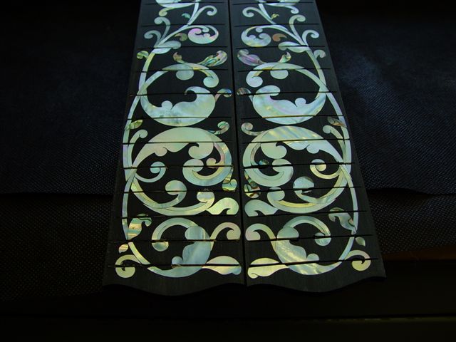

Just wanted to share a tip on attaching patterns to shell.
After trying many types of glue, I settled on non-toxic glue stick. Yes, the one your grade schooler used in arts and crafts!
It's water soluble,inexpensive, and easy to find.(Just rob your kid's bookbag!)
The trick is to coat your pattern and the shell blank. Let it dry for a minute and it's ready to cut.
It also works well when sending cut shell to a customer on a backer. It will hold firm, yet release in under a minute submerged in warm water.
Below is a recent "mirror image set" of inlays for Schwartz guitars.
Paul Bordeaux
http://www.bordeauxinlay.com

Beautiful inlay! And thanks about the tip re: coating both sides. I've used glue stick with good success just applying it to one surface, but it tends to flake up if you only apply it on one face!

I've been using CA to glue may pattern on shell blanks...and occassionally the edges of the paper pattern let go with the heat of jewellers blade. This doesn't happen with a glue stick?Anthony Z38795.4378703704

I have been using 3M's Scotch super strength glue.
It's a little goopy, but it's a one coat deal, and I have not found anything it doesn't stick to yet, all pearls, all metals, it doesn't heat up, it never lifts. I haven't given it the soapy water test, but I don't use that technique in my inlays. It does stay flexible long enough to peel or scrape off fragile pieces.
I hear some people can't find it though.
Nice stuff Paul! Very classy. I can't wait to see it after it's engraved.

I had the same problem with CA; The only time it's happened since going to glue stick is when I've managed to not coat an edge.

Craig, I actually use the Scotch brand of glue stick when I can find it.

You cut those by hand? It is a great job. Looks machine cut. I'll never be able to do that....

[QUOTE=Joe Beaver] You cut those by hand? It is a great job. Looks machine cut. I'll never be able to do that....[/QUOTE]
Joe, I was once told that I,"was not capable of cutting inlay", many years ago. That lit the fire under my hiney.
Never say never...
